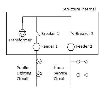

You can create a separate drawing to contain a internal view of a structure. For example, you might have a substation where a conductor in a segment is connected to an internal device (transformer/breaker/fuse). The internal devices are connected to each other with a conductor.
Before creating structure internal views, set the display model for the structure internal drawing and specify the size of the structure internal bounding box. See Set Electric Options.
If you use the Electric Explorer to insert a device where a device is already located, you are prompted to insert a structure and the devices are moved to the structure internal. If there is more than one structure at the location, you are prompted to specify the structure to which to associate the structure internal view. For more information about structure internals, see Create Structure Internal Views.

Structure Internal. A second .dwg is created for the structure internal.

The external feature (for example, conductor) must geometrically touch the structure containing the internal features.
For example, in the Conductor container, select a conductor and in the Device container, select a structure internal device. Use Select From Map
or Select From Trace
to populate the feature container with the correct feature. You can then select this feature in the feature container.
Connect With Internal Device. Alternatively, in the Device container, click More
Connect With External Conductor. You can also use drag and drop to make the connection.
A logical connection is made between the external and internal features.
The structure internal device is displayed in the Structure container in the Electric Explorer. A special icon indicates that the structure has an internal view.
