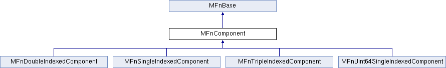

+ Inheritance diagram for MFnComponent:

Reimplemented in MFnDoubleIndexedComponent, MFnSingleIndexedComponent, MFnTripleIndexedComponent, and MFnUint64SingleIndexedComponent.
