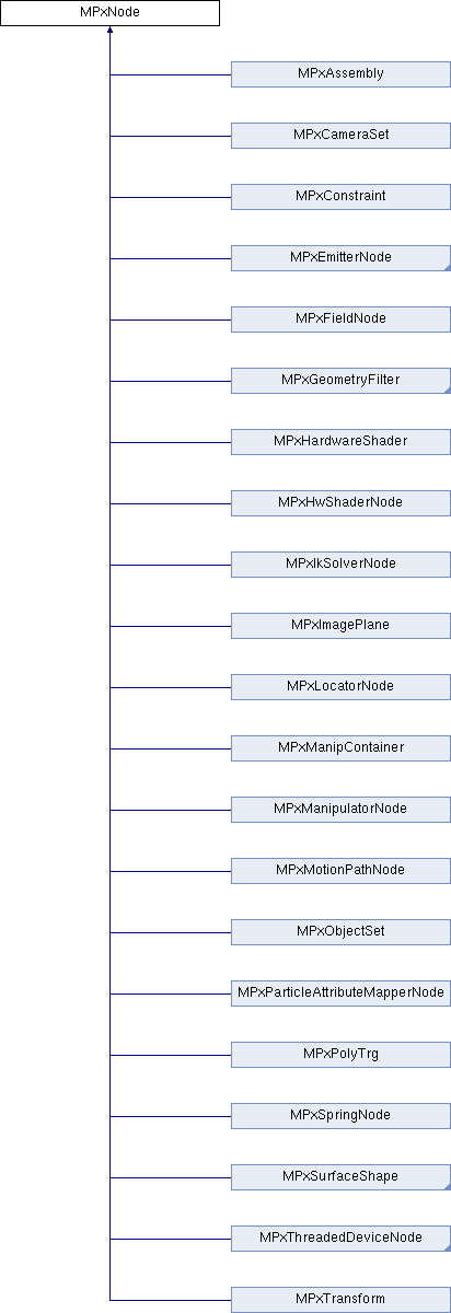

Base class for user defined dependency nodes. More...
#include <MPxNode.h>
+ Inheritance diagram for MPxNode:

Reimplemented in MPxAssembly, MPxGeometryFilter, MPxManipContainer, MPxHwShaderNode, MPxTransform, MPxThreadedDeviceNode, MPxHardwareShader, MPxMotionPathNode, MPxIkSolverNode, MPxClientDeviceNode, MPxEmitterNode, MPxSpringNode, MPxSurfaceShape, MPxLocatorNode, MPxImagePlane, MPxObjectSet, MPxFieldNode, MPxBlendShape, MPxDeformerNode, MPxFluidEmitterNode, MPxSkinCluster, MPxCameraSet, and MPxParticleAttributeMapperNode.
