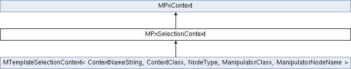

+ Inheritance diagram for MPxSelectionContext:
