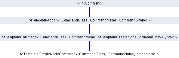

+ Inheritance diagram for MTemplateCreateNodeCommand< CommandClass, CommandName, NodeName >:

- Public Member Functions inherited from MTemplateCommand< CommandClass, CommandName, MTemplateCreateNodeCommand_newSyntax >

- Public Member Functions inherited from MTemplateAction< CommandClass, CommandName, CommandSyntax >

- Public Member Functions inherited from MPxCommand
