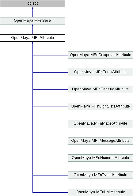

+ Inheritance diagram for OpenMaya.MFnAttribute:
