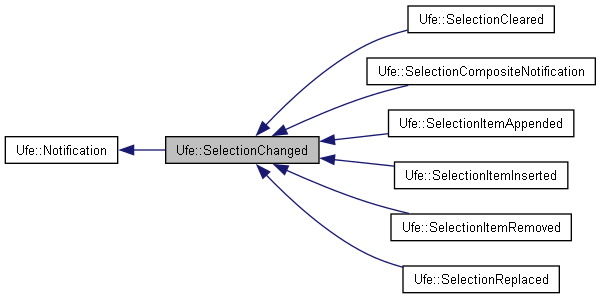

#include <selectionNotification.h>
Inheritance diagram for Ufe::SelectionChanged:
Collaboration diagram for Ufe::SelectionChanged:
