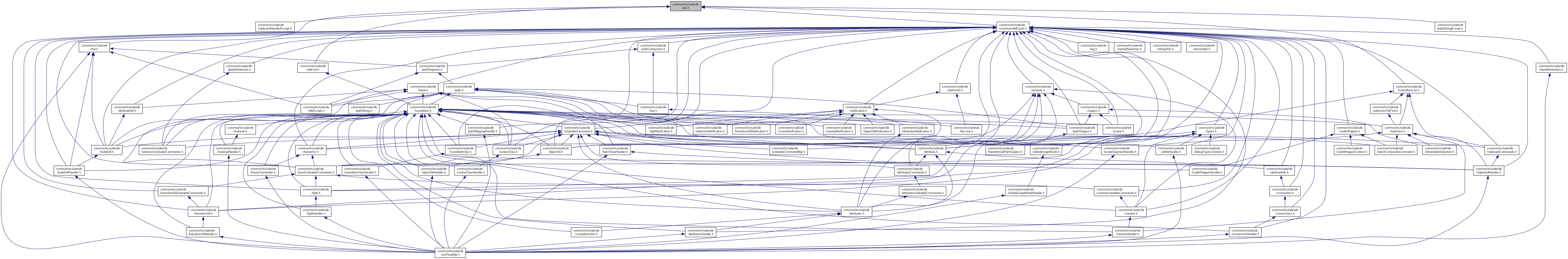

This graph shows which files directly or indirectly include this file:
