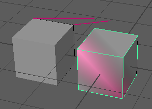

在下面提供的示例演示了如何将元数据的两个流(StreamOne 和 StreamTwo)附加到两个对象(smcPlane 和 smcPlane1)上的顶点,以及如何在 Viewport 2.0 中逐个可视化数据流。它以禁用可视化结束。

// NOTE: By default, all streams are hidden.
// Activate visualization of "StreamOne" for one cube. Use color mode.
showMetadata -stream "StreamOne" -member "Color" -dataType "float[3]" -method "color" smcPlane1Shape;
// Metadata is now visible.
// Auto remap the data range of the values in the stream.
showMetadata -stream "StreamOne" -member "Color" -dataType "float[3]" -method "color" -auto smcPlane1Shape;
// Enable color interpolation to extrapolate color to the faces surrounding the vertices
showMetadata -stream "StreamOne" -member "Color" -dataType "float[3]" -method "color" -interpolation true smcPlane1Shape;
// Activate visualization of "StreamOne" for the other cube. Use string mode.
showMetadata -stream "StreamOne" -member "Color" -dataType "float[3]" -method "string" smcPlaneShape;
// Metadata is now visible on both cubes.
// Now, activate visualization of "StreamTwo" for the second cube. Use ray mode.
showMetadata -stream "StreamTwo" -member "Color" -dataType "float[3]" -method "ray" smcPlaneShape;
// The rays appear too long.
// Scale the length using the rayscale flag.
showMetadata -stream "StreamTwo" -member "Color" -dataType "float[3]" -method "ray" -rayScale 0.3 smcPlaneShape;
// The visible metadata has now changed, and you have now used all three methods of display.
// Deactivate the stream.  To turn off visualization on an object, specify the stream name and use the off flag.
showMetadata -stream "StreamTwo" -member "Color" -dataType "float[3]" -off smcPlaneShape;
// Now metadata is no longer visible on the second cube (smcPlaneShape)
在此示例中,在 smcPlaneShape 上以光线模式可视化 StreamTwo,其中“光线长度比例”(Ray length scale)设置为 0.3,而在 smcPlane1Shape 上以颜色模式可视化 StreamOne,其中数据范围自动重映射且颜色插值已启用。
