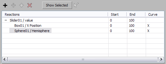

  5. On the upper toolbar, click (Add Driver), and then click the Slider manipulator in the Perspective viewport.
  6. On the pop-up menu that appears, choose Object (Slider) value.
    In the Reactions list, the reaction driver entry Slider01 / value appears.
  7. On the upper toolbar, click (Add Driven), and then click the box in the Perspective viewport.
  8. On the pop-up menu that appears, choose Transform Position X Position.
    In the Reactions list, the reaction driven entry Box01 / X Position appears under the reaction driver entry. Also, a new state appears in the States list for the newly added reaction driven track. This simply says that, when the slider value is 0, the box's X position should be what it is. However, a reaction needs at least two states to be meaningful. You'll learn how to accomplish this shortly.

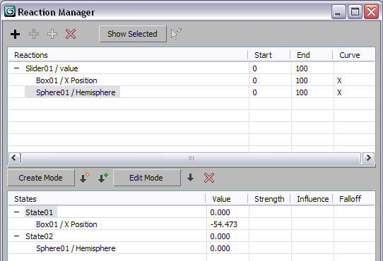

    The sphere's Hemisphere track is added as a reaction driven of the slider, and a new state for the two is added to the States list.
    You now have two states in the States list, but in both cases the state value (that is, the slider value) is the same, so you really need only one. You can resolve this by adding the Hemisphere reaction driven track to the first state and then eliminating the second state.
  12. In the Reactions list, click the Sphere01 / Hemisphere entry, and in the States list, click the State01 entry.
  13. On the center toolbar, above the States list, click (Append Selected).
    This adds the Hemisphere track to State01.
    Now you can delete the second, superfluous state.
  14. In the States list, click the State02 entry, and then on the toolbar above the States list, click (Delete State).
    State02 goes away.

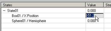

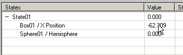

  15. In the States list, position the click and hold the mouse cursor over the Box01 / X Position Value entry.
    Note: Your value probably differs from that shown in the illustration.
  16. Drag upward to increase the value, or downward to decrease the value. Change the value to about –50.0.
    You might find it difficult to set an exact value by dragging, which changes only the tenths (and higher) value. You can use the keyboard to specify a more exact value.
  17. Double-click the value.
    The value highlights and becomes a keyboard-editable field.
  18. Enter –50 and press Enter or Tab.
    The value now displays as –50.000.

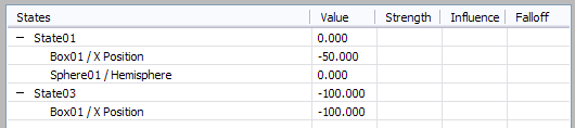

  22. In the Reactions (upper) list, click the Box01 / X Position entry to highlight it, and then move the box about –50 units on the X axis, to about X=–100.
    Highlighting the driven entry lets you manipulate the driven value interactively in the viewport while Create Mode is on. Then, when you click Create State, a new state is created for that driven entry only. If you highlight the reaction driver instead, you can manipulate all driven entries freely, but then clicking Create State creates a state for all driven entries. Reaction Manager is a complex tool, so in general it's best to keep the data as simple as possible.

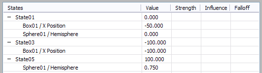

  23. Click (Create State).
    The Reaction Manager adds a new state, State02, with the state (slider) value at –100.0, and the box at its new X position.
  24. Turn off Create Mode. Move the slider left and right to see how this affects the box position.
    Next, you'll set a new state so the right half of the slider range affects the sphere's Hemisphere value.
  25. Select the sphere and go to the Modify panel.
    The Hemisphere parameter is unavailable, because it's driven by the slider value.

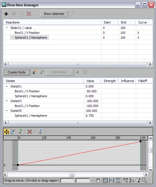

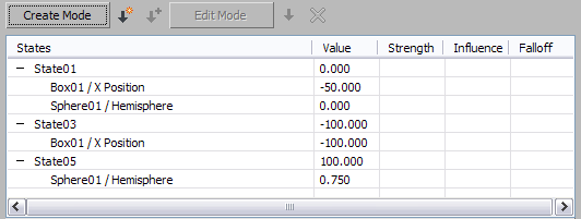

  26. Turn on Create Mode, and then and in the Reactions list, click the Sphere01 / Hemisphere entry.
    The Hemisphere parameter is now available.
  27. On the Modify panel, set Hemisphere to 0.75.
  28. In the Perspective viewport, drag the slider all the way to the right.
  29. Click (Create State).
    The Reaction Manager adds a state with the state (slider) value at 100.0, and the Sphere01 / Hemisphere value at 0.750.
    Also, if you click Slide01 / Value in the Reactions list, you can see in the graph showing the slider value on the horizontal axis and the two reactions on the vertical axis. The scale between the two is different, so the Hemisphere reaction on the right side of the graph looks like a straight line, but when you click Sphere01 / Hemisphere in the Reactions list, the graph shows a steady rise from 0.0 to 0.75.
  30. Turn off Create Mode. Drag the slider in both directions.
    Over the left half of the slider range, the box moves along the X axis. Over the right half of the range, the sphere's Hemisphere value changes.

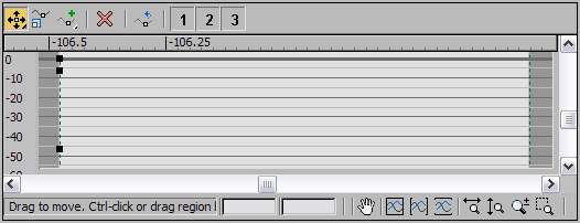

    To finish the procedure, you'll experiment with using the graph to change a reaction.
  31. If you haven't already, click the Sphere01 / Hemisphere driven entry in the Reactions list, and then click (Zoom Extents) below the graph.
  32. Click (Add Point), and then click the middle of the graph curve (it's the red, diagonal line).
    This adds a new point to the curve and a new state in the States list.
  33. Click (Move), and then drag the new point upward so it's above the right-hand endpoint.
  34. Drag the slider again.
    As the slider moves from 0 to 100, the Hemisphere value increases so much that the sphere disappears, and then decreases so you can see the upper fourth of the sphere.
