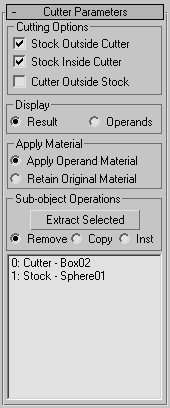

Cutter Parameters rollout
You can choose any combination of the three cutting options to get the desired result. If you have non-closed meshes, the orientation of the mesh might determine which part of the stock is considered to be inside or outside the cutter.
Cutting Options group
- Stock Outside Cutter
- The result contains the parts of the stock outside of all of the cutters. This option gives you a similar result to a Boolean subtraction of the cutters from the stock objects. The gold part of the object in the following illustration results from this option.
- Stock Inside Cutter
- The result contains the parts of the stock inside one or more cutters. This option gives you similar results to a Boolean intersection of the cutters and the stock objects. There is some difference because each cutter is treated individually. The green, blue and red parts of the object on the left side of the following illustration are the results of this option.
- Cutter Outside Stock
- The result contains the parts of the cutters that are not inside the stock objects. Note that the cutters will cut each other if they intersect also.
The right side of the following illustration (exploded for visibility) shows, as the result of this option, the parts that are not present on the left side.
Cylinder and sphere as cutters and box as stock:
Left: Keeping stock inside and outside cutters
Right: Keeping stock inside/outside cutters and cutters outside stock
Display group
- Display
- Choose one of the following display modes:
- Result Displays the result of the Boolean operations.
- Operands Displays the operands that define the Boolean result. Use this mode to edit the operands and modify the result.
Apply Material group
Choose one of the following material application modes:
- Apply Operand Material New faces created by the Boolean operation acquire the material of the operand.
- Retain Original Material New faces created by the Boolean operation retain the material of the original object.
Sub-object Operations group
These functions operate on operands highlighted in the hierarchy view list (see following).
- Extract Selected
Based on the chosen radio button (Remove, Copy, or Inst; see following), Extract Selected applies the operation to the highlighted operand in the hierarchy view list. Three modes of extraction are available:
- Remove Removes the operand or operands highlighted in the hierarchy view list from the Boolean result. It essentially undoes the addition of the highlighted operand(s) to the Boolean object. Each extracted operand becomes a top-level object again.
- Copy Extracts a copy of the operand highlighted in the hierarchy view list. The original operand remains part of the Boolean.
- Inst Extracts an instance of the operand highlighted in the hierarchy view list. Subsequent modifications to this extracted operand also modify the original operand, thus the Boolean object.
- [hierarchy view]
- The hierarchy view displays a list of all operands: cutters and stock objects. You can select and edit objects using the hierarchy view, as with ProBoolean.

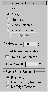

Advanced Options rollout
Update group
These options determine when updates are performed on the Boolean object after you make changes. Choose one of the following:
- Always Updates occur as soon as you make changes to the Boolean object.
- Manually Updates occur only when you click the Update button.
- When Selected Updates occur whenever the Boolean object is selected.
- When Rendering Updates are applied to the Boolean object only at render time, or when you click Update.
- Update
- Applies changes to the Boolean object. Available with all options except Always.
Note: When you first create a ProCutter object with Manually or When Rendering active, no operands, including the base object, are visible until you update at least once. Thereafter, the base object is visible, but no subsequently picked operands are until you update again.
- Decimation %
- The percentage of edges to remove from the polygons in the Boolean object, thus reducing the number of polygons. For example, a Decimation % setting of 20.0 removes 20 percent of the polygon edges.
Quadrilateral Tessellation group
- Make Quadrilaterals
- When on, changes the tessellation of the Boolean object from triangles to quadrilaterals. This makes the object suitable for editing
subdivision surfaces and for smoothing meshes. It also makes the object suitable for conversion to Editable Poly format.
- Quad Size %
- Determines the size of the quadrilaterals as a percentage of the overall Boolean object length.
Planar Edge Removal group
This option determines how the polygons on planar faces are handled. Choose one of the following:
- Remove All Removes all extra coplanar edges on a face such that the face itself will define the polygon.
- Remove Only Invisible Removes invisible edges on each face.
- No Edge Removal No edges are removed.
