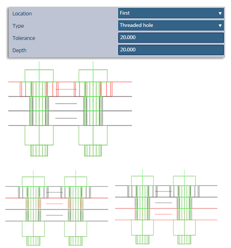

In this tab you can configure the way the holes are created by default, when the bolts are inserted in the 3D model.
There are 3 types of holes you can choose from, each type having a set of parameters.
| Location |
This sets which element the specific configured type of hole will be created on, when the bolts go through several elements. If you select First / Last, the hole type set here will be created only on the first / last element through which the bolts go. By default, round holes will be created through the rest of the elements. If you choose All, the specific configured hole type will be created on all the elements. ![]() |
| Type | The hole type (e.g. round, threaded, countersunk.) |
| Tolerance | The value defining the distance between the bolt body and the hole edge. |
| Depth |
The value that defines the depth of the hole through the element (not available for round holes). Note: For countersunk holes, this parameter defines the depth of the bolt head.
| Angle | The value that defines the angle at which the bolt head hole pierces the element. This parameter is available only for countersunk holes.
| Head diameter | The value that defines the diameter of the bolt head hole. This parameter is available only for countersunk holes. |
