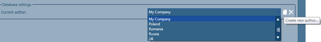

Database settings
Current author:

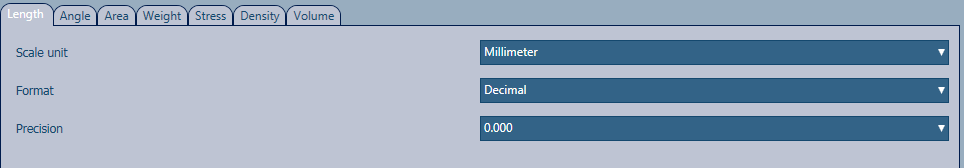

Unit Selection category. This category includes the units used during your bolts / anchors or shear studs customization in Management Tools:

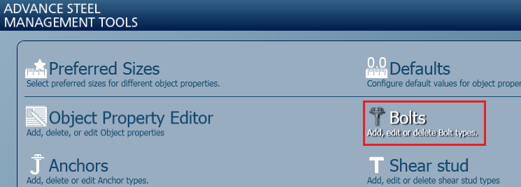

To access the customization settings for bolts in Advance Steel:
Settings panel or to the Tools tab
Tools panel and click
