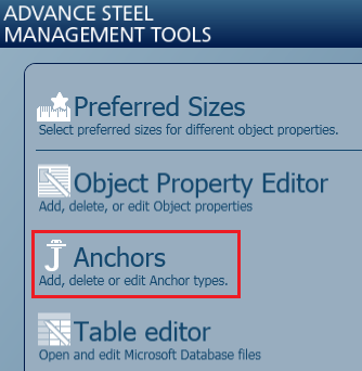

To access the customization settings for anchors in Advance Steel:
Settings panel or to the Tools tab
Tools panel and click
