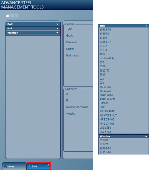

Before you create a bolt/anchor assembly (in the Set tab) you need to first define the washers and the nuts, in order to add them to your assembly. While there is a number of predefined nuts and washers, you can also create your own customized ones.
On the left side of the Management Tools application window, while in the Bolts or Anchors category, you also have two other headlines for Nut and Washer. If you expand the lists, you will see the already defined nut and washer types:

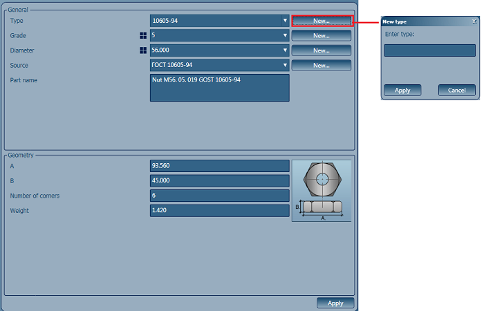

Clicking on one of the nut or washer types brings up their properties page on the right side of the application window. Here you can modify the parameters of existing types, duplicate an existing type or create new types by clicking the New button next to the Type drop-down list.
You need to choose valid parameters in order to be able to create the new type and save your settings. After entering all the required parameters, click Apply to save your new nut or washer type.
