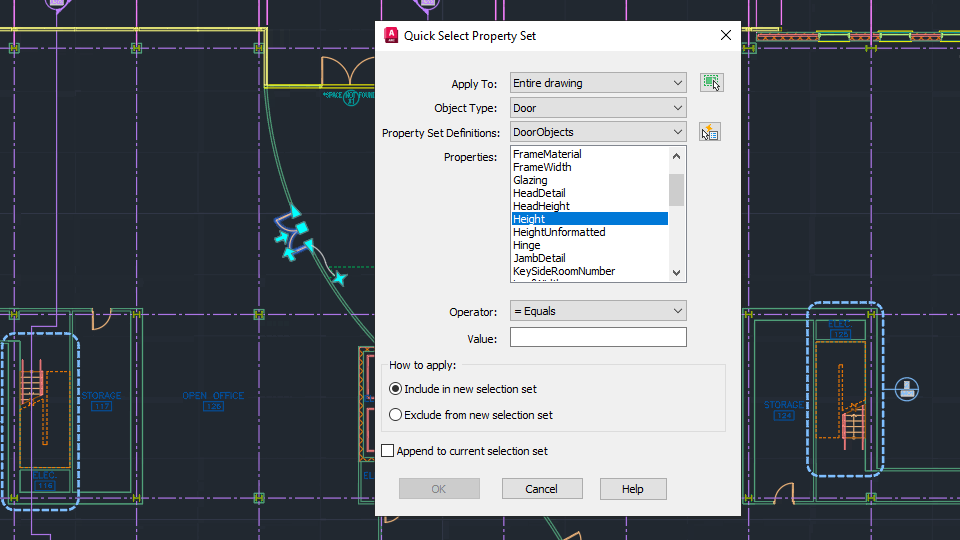

Quick Select Property Set
QSELECTPROPERTYSET creates a selection set by filtering object type and property set. For example, you can select all similar objects in a drawing that share the same property set values.
This new command simplifies the process of identifying and working with similar objects, saving time and reducing errors, especially in complex drawings.
New Command
QSELECTPROPERTYSET - Creates a selection set based on filtering criteria derived from the properties in the property set definition.
