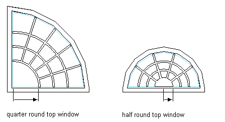

You can add the sunburst pattern only to the top window sash. You can apply the sunburst pattern to window shapes with a round, half round, or quarter round top.

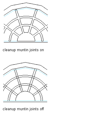

| convert the muntin intersections to corners | under Muntin, select Clean Up Joints. |
| convert all the muntins to one body with the joints cleaned up | under Muntin, select Convert to Body. |
Specifying sunburst muntin cleanup joints

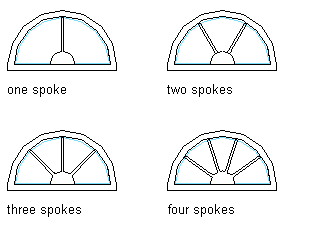

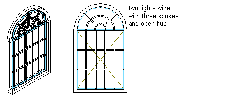

Specifying number of spokes for sunburst muntins

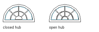

Specifying sunburst muntin open and closed hubs
Specifying sunburst muntin hub radius
