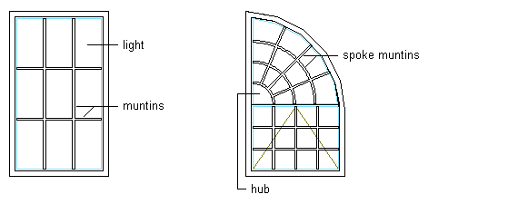

Window muntins are secondary framing members that hold multiple panes of glass in a window sash. AutoCAD Architecture 2026 toolset provides an easy way to create muntins with different layout patterns.
Window muntins are available in several patterns that you can customize into many different styles:
Starburst and Sunburst patterns are a combined-rectangular pattern with a half-round or quarter-round spoked top and can be used for half- and quarter-round as well as rectangular muntins. Gothic is similar but has a gothic muntin pattern. The other patterns are primarily rectangular but fit into half-round window sash.
You can make custom shapes for window muntins by creating profiles from polylines and adding them to a new window style.
Window muntin components
