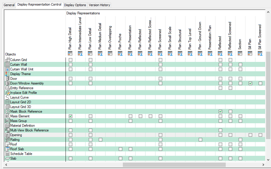

The right pane contains a matrix that lists each object and display representation. A check mark under a display representation indicates that the display set uses this representation to show the corresponding object. For example, in the Model display set, most objects use the Model display representations.
Display representations selected for each object in the Model display set

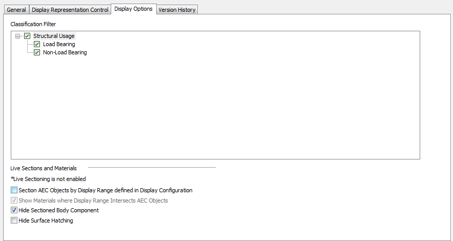

Settings on this tab enable you to filter objects by their classification. In addition, you can specify settings that affect how materials are displayed when you generate a live section view of a building model.
Display options specified for a selected display set
