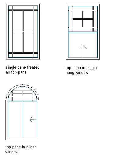

| the top sash only | under Window Pane, select Top. Top also applies to single sash. |
| all sash | under Window Pane, select Other, and select All. |

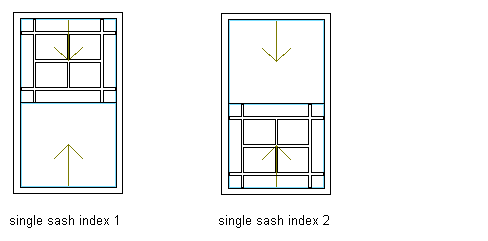

| an individual sash component | under Window Pane, select Other. Select Single, and specify the index number for window sash. Sash is indexed counterclockwise, starting from the lower left corner. |
Specifying prairie-12 lights muntins for top sash
Specifying muntins to an individual sash component

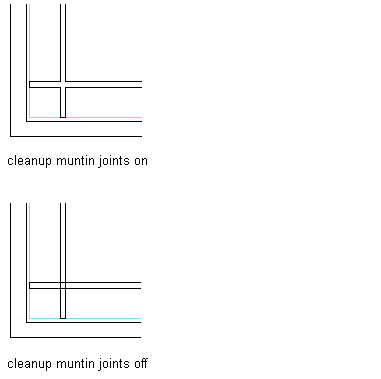

| If you want to… | Then… |
| convert the muntin intersections to corners | under Muntin, select Clean Up Joints. |
| convert all the muntins to one body with the joints cleaned up | under Muntin, select Convert to Body. |
Specifying muntin cleanup joints

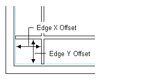

Specifying prairie-12 lights pattern muntin edge X and Y offsets
