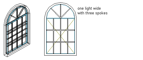

You can add the starburst pattern only to the top window sash. You can apply the starburst pattern to window shapes with a round, half round, or quarter round top.
You can apply the starburst pattern to the following window types: awning, single hopper, single transom, vertical pivot, horizontal pivot, double hung, glider, single hung, single casement, and picture.

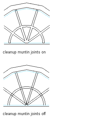

| convert the muntin intersections to corners | under Muntin, select Clean Up Joints. |
| convert all the muntins to one body with the joints cleaned up | under Muntin, select Convert to Body. |
Specifying starburst muntin cleanup joints

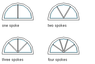

Specifying number of spokes for starburst muntins
