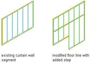

Modifying a curtain wall floor line by adding a step
A third vertex is added to the line halfway between the two ends of the line and four feet from the line. A step is created from the selected vertex to the second vertex.
