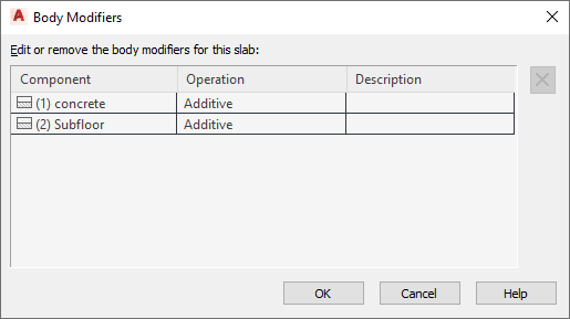

- Select the slab or roof slab you want to change, and
| if the object selected is… |
then… |
| a slab |
click   . |
| a roof slab |
Note: You can also access this worksheet on the Design tab of the Properties palette, under Advanced.
- Select a body modifier, and change its settings:
| If you want to … |
Then … |
| apply the body modifier to a different slab or roof slab component |
select a different component for Component. |
| change the operation used to apply the body modifier to the slab or roof slab component |
select a different operation for Operation: - Select Additive to add the body modifier to the component.
- Select Subtract to subtract the shape of the body modifier from the component.
- Select Replace to replace the component with the body modifier.
| delete the body modifier from the slab or roof slab component |
select the body modifier, and click , or right-click, and click Remove. |
| enter a description of the body modifier |
click Description, enter text, and press Enter. |
- Click OK.
