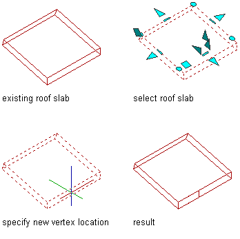

Adding a vertex to a roof slab
A new Vertex grip is displayed at the point you specified, and new grips are displayed for the edge that has been added.
