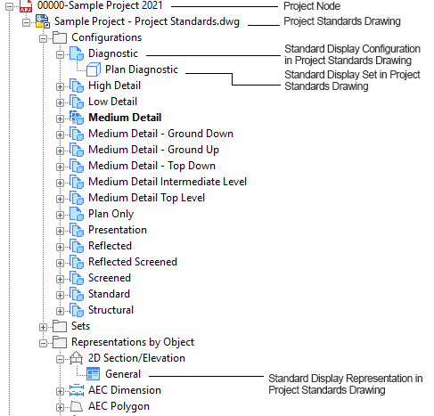

Project standards in Display Manager

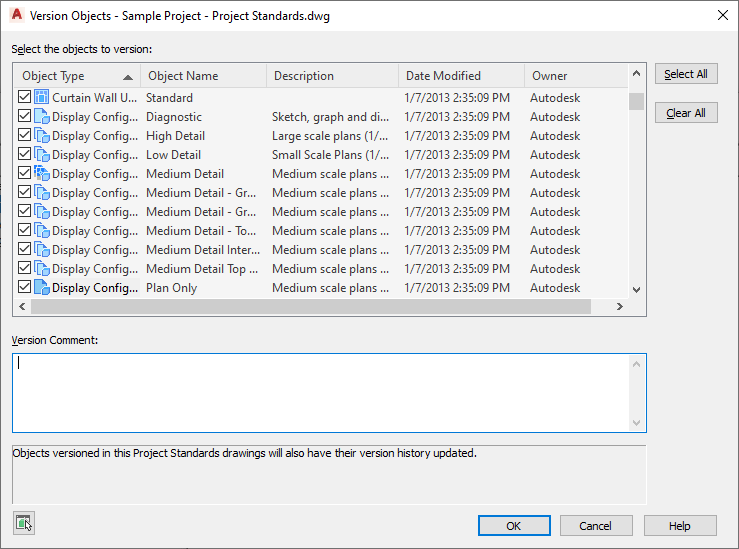

The new version is appended to the Version History tab.
The comment will be applied to all objects selected for versioning.
