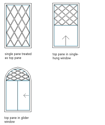

| the top sash only | under Window Pane, select Top. Top also applies to single sash. |

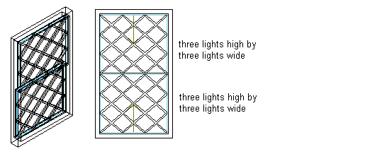

| all sash | under Window Pane, select Other, and select All. |

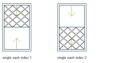

| an individual sash component | under Window Pane, select Other. Select Single, and specify the index number for window sash. Sash is indexed counterclockwise, starting from the lower left corner. |
Specifying diamond muntins for top sash
Specifying diamond muntins to an individual sash component

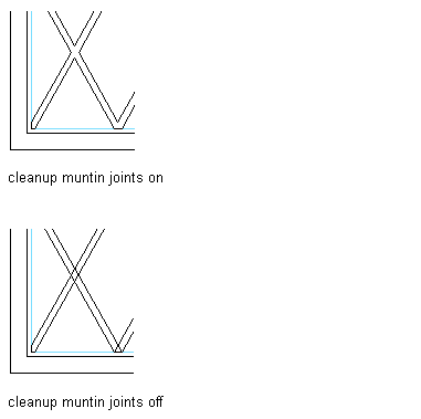

| convert the muntin intersections to corners | under Muntin, select Clean Up Joints. |
| convert all the muntins to one body with the joints cleaned up | under Muntin, select Convert to Body. |
Specifying diamond muntin cleanup joints
