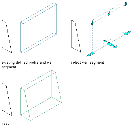

Use this procedure to create a custom wall or a wall component by defining its shape from a profile.
You can create the profile as you add it to a wall. However, if the shape you need is elaborate and has curved segments, you may find it easier to create the profile from a polyline first. You can then add the profile to the wall.
Adding a sweep profile to a wall

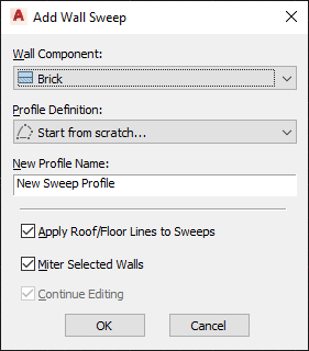

. If you want to define the sweep after you apply it to the component, select Start from scratch, and enter a name for the profile.
Specifying settings for a wall sweep
| If you want to … | Then … |
| apply existing roof line or floor line conditions to the sweep | select Apply Roof/Floor Lines to Sweeps. |
| use the geometry of the sweep to define the roof line and the floor line | clear Apply Roof/Floor Lines to Sweeps. |
| miter the intersection of the wall containing the sweep and other walls | select Miter Selected Walls. |
| prevent mitering the intersection of the wall containing the sweep and other walls | clear Miter Selected Walls. You can miter the walls later, if needed. You can also adjust the miter angles. |
| change the geometry of the sweep when it is applied to the wall | select Continue Editing. |
| use the existing geometry of the profile to define the sweep | clear Continue Editing. |
