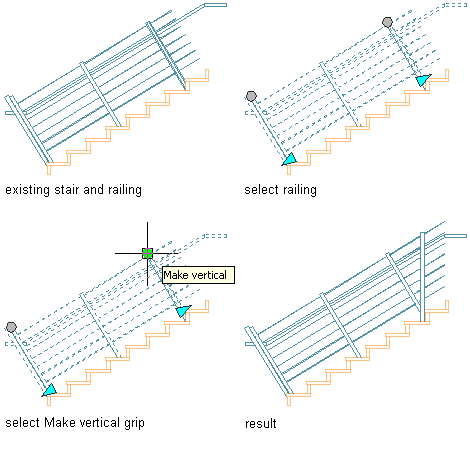

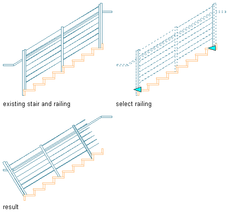

Use this procedure to specify perpendicular or vertical railing orientation relative to a stair flight. By default, railing have a vertical orientation when you create them.
Specifying perpendicular railings

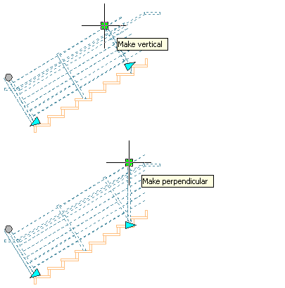

Once a perpendicular railing orientation has been specified, you can use grips to change first and last posts to a vertical orientation.
The Make vertical grip changes to a Make perpendicular grip once you have specified a vertical orientation for the railing post. Select the Make perpendicular grip to return the post to a perpendicular orientation.
Viewing post orientation grips

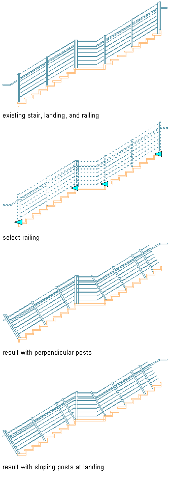

When a stair has a landing, you also have the option of specifying the orientation of landing posts.
Specifying landing post orientation
