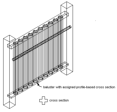

Assigning a profile to a baluster in a railing
