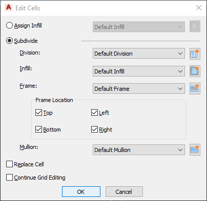

Press Ctrl to select multiple cells, bays, columns or nested grids.
The Edit Cells worksheet displays.
| If you want to… | Then… |
| assign an infill to selected cells | select Assign Infill and select an infill definition. Clear Replace Cell and click OK. |
| replace the selected cells with a new infill | select Assign Infill and select an infill definition. Select Replace Cell and click OK. |
| create and assign a new infill to the selected cells | click |
| divide the selected cells with divisions, infills or frames | select Subdivision. |
| add a division to the subdivided cells | select a division definition. |
| create and assign a new division to the selected cells | click |
| select an infill for the subdivided cells | select an infill definition. |
| create and assign a new infill to the subdivided cells | click |
| select a frame definition for the grid created after the cell is subdivided | select the frame definition and click OK. |
| specify the location of frames on the grid created after the cell is subdivided | select Top, Bottom, Left, Right for Frame Location and click OK. |
| create and assign a new frame definition for the new grid created after the cell is subdivided | click |
| select a mullion definition for the grid created after the cell is subdivided | select the mullion definition. |
| create and assign a new mullion definition to the selected grid | click |
| replace the existing cell infill with the options selected on this worksheet | select Replace Cell. |
| continue in-place editing the grid after the cell is subdivided | select Continue Grid Editing. |
