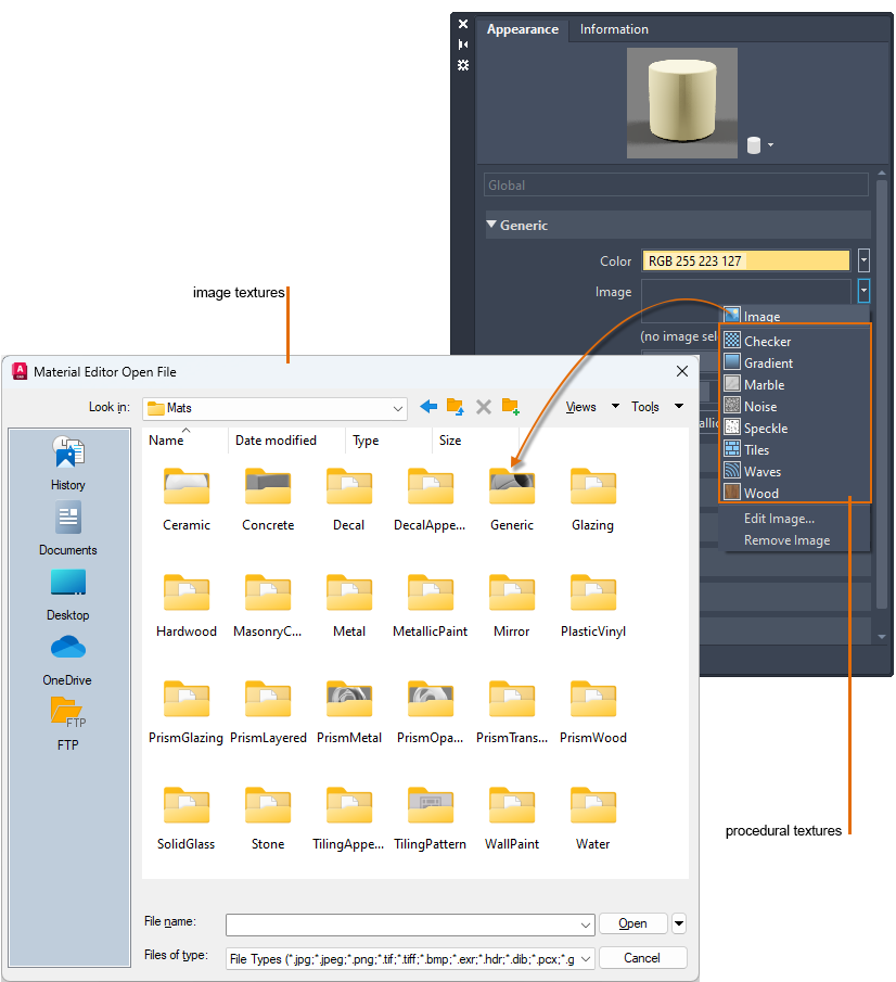

There are two types of textures: image and procedural.
Use an image to represent a texture. For example, you can use an image of wood, concrete conglomerate, metal, carpet, or basketry.
You can edit the texture scale and other properties to customize it to your model.
The product provides a library of images that you can use with textures. You can also add your own textures using the following file types:
Use a procedural texture generated by a mathematical algorithm to represent repetitive textures such as tiles or wood. You can adjust the texture properties for the effect you want. For example, you can adjust tile size and mortar spacing for a brick material or change the spacing of the grain in a wood material.
The types of settings for a procedural texture vary. You nest them to add depth and complexity to the material.
