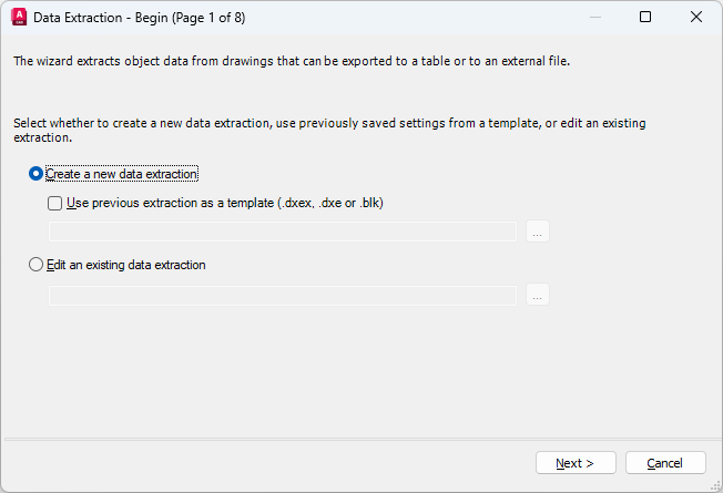

The Data Extraction wizard includes the following pages:
Starts the data extraction process. Options include creating a new data extraction, using a template, or editing an existing data extraction.
Creates a new data extraction and saves it to a DXEX file. You can also specify a previous extraction file (BLK, DXE, or DXEX) to use as a template file.
Uses settings previously saved in a data extraction (DXE or DXEX) file or an attribute extraction template (BLK) file. As you move through the wizard, each page is already filled in with the settings in the template file. You can change these settings. Click the [...] button to select the file in a standard file selection dialog box.
Allows you to modify an existing data extraction (DXEX) file. Click the [...] button to select the data extraction file in a standard file selection dialog box.

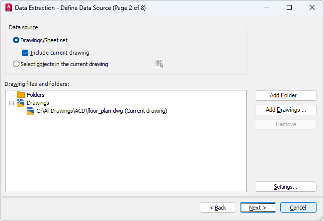

Specifies the drawing files, including folders from which to extract data. Allows selection of objects in the current drawing from which to extract information.
Makes the Add Folder and Add Drawings buttons available for specifying drawings and folders for the extraction. The drawings and folders for the extraction are listed in the Drawing Files view.
Includes the current drawing in the data extraction. The current drawing can be empty (not contain objects) if additional drawings are selected for extraction.
Makes the Select Objects in the Current Drawing button available so you can select objects for data extraction.
Closes the wizard temporarily so that you select objects and blocks in the current drawing.
Lists the selected drawing files or folders. Checked folders are included in the extraction.
Displays the Add Folder Options dialog box, where you can specify folders to include in the data extraction.
Displays the standard file selection dialog box, where you can specify drawings to include in the data extraction.
Removes the checked drawings or folders listed in the Drawing Files and Folders list from the data extraction.
Displays the Data Extraction - Additional Settings dialog box, where you can specify data extraction settings.
You can see the shortcut menu for Folders (and the drawings listed within the selected folder) only after you explicitly add a folder using the Add Folder button.
Displays the Add Folder Options dialog box where you can specify the folders to be used for data extraction. Drawings in the selected folders are monitored for data changes.
Removes the selected folder.
Selects all the drawings listed below the selected folder.
Clears all the drawings listed below the selected folder.
Inverts the current selected items below the selected folder.

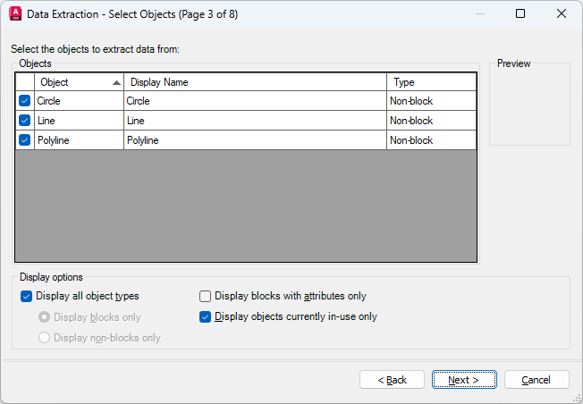

Specifies the types of objects (blocks and non-blocks) and drawing information to be extracted.
Valid objects are checked by default. Objects that do not exist in the selected drawing are not checked. Click the column head to reverse the sort order. Columns can be resized. Property data from checked objects is displayed on the Select Properties page.
Displays each object by its name. Blocks are listed by block name. Non-blocks are listed by their object name.
Provides a place to enter an optional alternative name for an object as it will appear in the extracted information. Select a display name, right-click in the list, and click Edit Display Name.
Displays whether the object is a block or non-block.
Displays a preview image of the checked block in the Object list view.
Displays a list of all object types (blocks and non-blocks) in the Object list view. This option is selected by default.
Displays only blocks in the Object list view.
Displays only those objects that are not blocks in the Object list view.
Displays only those blocks in the Object list view that contain attributes. Dynamic blocks are listed if they have special properties assigned to them (for example, actions and parameters).
Displays objects in the Object list view that exist in the selected drawings.

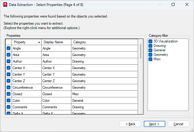

Controls the object, block, and drawing properties to extract.
Each row displays a property name, its display name, and category.
Right-click a column head and use options on the shortcut menu to check all or clear all items, invert the selection set, or edit the display name. Click the column head to reverse the sort order. Columns can be resized.
Displays object properties from objects selected on the Select Objects page. The property list is filtered according to the filter categories that are selected. Properties are the same as those listed in the Properties palette.
Provides a place to enter an optional alternative name for a property as it will appear in the extracted information. Select the property display name, right-click in the list, and click Edit Display Name.
Displays a category for each property. For example, General designates ordinary object properties, such as color or layer. Attribute designates user-defined attributes. Dynamic designates user-defined property data for dynamic blocks. Categories are the same as those listed in the Properties palette.
Displays a list of categories that are extracted from the property list. Unchecked categories filter the Properties list. Categories include 3D Visualization, Attribute, Drawing, Dynamic Block, General, Geometry, Misc, Pattern, Table, and Text.
Selects all the properties in the property grid.
Clears all the properties in the property grid.
Inverts the current checked items in the property grid.
Allows in-place editing of the property display name for the selected row.

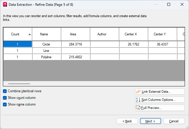

Modifies the structure of the data extraction table. You can reorder and sort columns, filter results, add formula columns and footer rows, and create a link to data in a Microsoft Excel spreadsheet.
Displays properties in a columnar format as they were specified in the Select Properties page. Right-click any column header to display a shortcut menu of options. The Count column and Name column display by default. Icons display in the column header for inserted formula columns and columns extracted from a Microsoft Excel spreadsheet.
Groups identical records by row in the table. Updates the Count column with the sum of all aggregated objects.
Displays the Count column in the grid.
Displays the Name column in the grid.
Displays the Link External Data dialog box, where you can create a link between the extracted drawing data and data in an Excel spreadsheet.
Displays the Sort Columns dialog box, where you can sort data across multiple columns.
Displays a full preview of the final output, including linked external data, in the text window. The preview is for viewing only.
Sorts column data in a descending order.
Sorts column data in an ascending order.
Allows in-place editing of the selected column name.
Hides the selected column.
Displays the hidden column. The flyout option includes Display All Hidden Columns.
Displays the Set Cell Format dialog box, where you can set a data type for cells in the selected column.
Displays the Insert Formula Column dialog box, where you can specify the formula that is inserted into the table. Inserts the formula column to the right of the selected column. An existing formula column cannot be used as a value for another formula column.
Displays the Edit Formula Column dialog box. This option is only available when a formula column is selected.
Removes the selected formula column. This option is only available when a formula column is selected.
Displays numeric data in the selected column as separate values or collapses identical property rows into one row and displays the sum of all the numeric data in the selected column. This option is available when the Combine Identical Rows is checked and the selected column contains numerical data.
Displays a Count column that lists the quantity of each property.
Displays a Name column that displays the name of each property.
Displays a flyout menu with options for Sum, Max, Min, and Average. Creates a footer row for the selected column that is placed below all the data rows and displays values based on the selected arithmetic function. This option is available only for columns that have a numeric data type.
Displays a sum of all the values in the selected column in a footer row.
Displays the maximum value in the selected column in a footer row.
Displays the minimum value in the selected column in a footer row.
Displays the average value in the selected column in a footer row.
Removes the Totals footer. This option is available when a footer row exists.
Displays the Filter <ColumnName> dialog box, where you can specify filter conditions for the selected column.
Restores the default filter for the selected column.
Restores default filters for all columns that have filters.
Copies all the data cells, including column names, to the Clipboard.

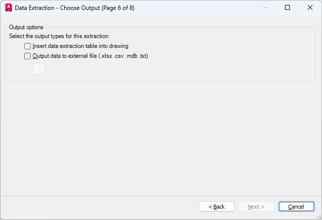

Specifies the type of output to which the data is extracted.
Creates a table that is populated with extracted data. You are prompted to insert the table into the current drawing when you click Finish on the Finish page.
Creates a data extraction file. Click the [...] button to select the file format in a standard file selection dialog box. Available file formats are Microsoft Excel (XLSX), comma-separated file format (CSV), Microsoft Access (MDB), and tab-separated file format (TXT). The external file is created when you click Finish on the Finish page.
The maximum number of columns that can be exported to an XLSX and MDB file is 255.

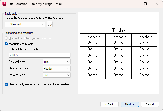

Controls the appearance of the data extraction table. This page is displayed only if AutoCAD Table is selected on the Choose Output page.
Specifies the table style. Click the Table Style button to display the Table Style Dialog Box, or select a table style from the drop-down list that is defined in the drawing.
Creates the data extraction table with a set of top rows that contain label cells and a bottom set of label rows that contain header and footer cells. Extracted data is inserted between the top and bottom label rows. This option is only available when the selected table style contains a template table.
Provides for manually entering a title and specification of the title, header, and data cells style.
Specifies a title for the table. This row is not overwritten when the table is updated. The default table style, STANDARD, includes a title row. If the selected table style does not include a title row, this option is not available.
Specifies the style for the title cell. Click the drop-down list to select a title cell style defined in the selected table style.
Specifies the style for the header row. Click the drop-down list to select a cell style defined in the selected table style.
Specifies the style for data cells. Click the drop-down list to select a cell style defined in the selected table style.
Includes column headers and uses the Display Name as the header row.
Displays a preview of the table layout. If the table style does not include a title row or header row, none is displayed.

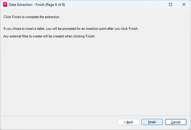

Completes the process of extracting object property data that was specified in the wizard and creates the output type that was specified on the Choose Output page. If data linking and column matching to an Excel spreadsheet was defined in the Link External Data dialog box, the selected data in the spreadsheet is also extracted.
If the Insert Data Extraction Table into Drawing option was selected on the Choose Output page, you are prompted to insert the table into the drawing when you click Finish.
If the Output Data to External File option was selected, the extracted data is saved to the specified file type.
