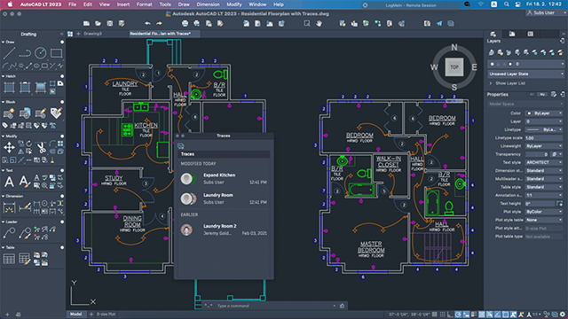

Trace provides a safe space to collaborate on drawing changes without fear of altering the existing drawing. The analogy of trace is a virtual, collaborative tracing paper that's laid over the drawing, allowing collaborators to add feedback right in the drawing.

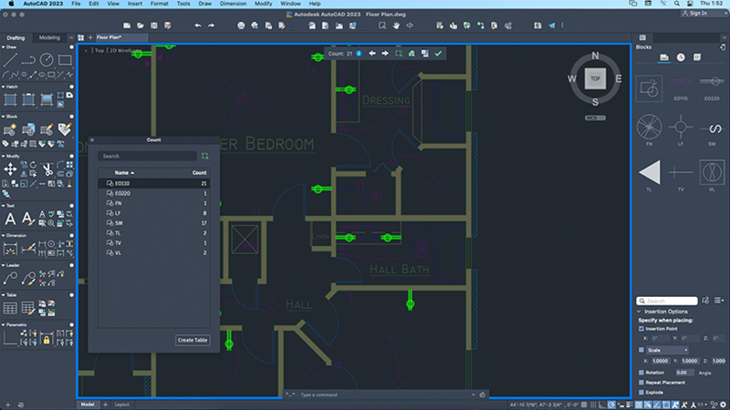

Quickly and accurately count the instances of blocks or other selected objects in a drawing. You can insert a table with the block count data into the current drawing.

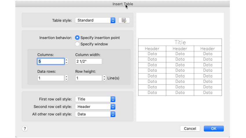

Create a table object using the new Insert Table dialog box where you can select table and cell styles, specify the number of rows and columns, and more.
