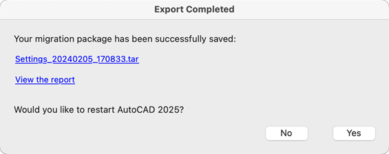

    You are prompted to save any unsaved drawings and then AutoCAD closes.
    The dialog box displays.
  6. Click View Report to view details on which files were exported.
  7. Click Yes to restart AutoCAD.

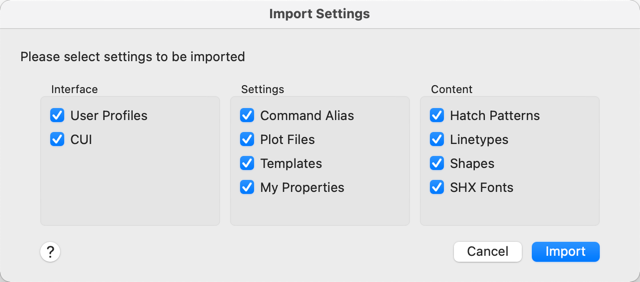

Import Custom Settings in AutoCAD for Mac
  1. Click Tools menu > Import Settings.
  2. Click OK on the alert.
  3. Browse to and select the export file created previously and click Open.
    The Import Settings dialog box displays.
  4. Select or clear settings as needed and click Import.

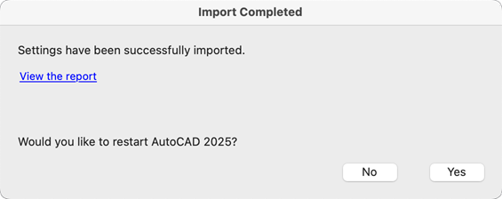

  5. Click View Report to view details on which files were imported.
  6. Click Yes to restart AutoCAD.
