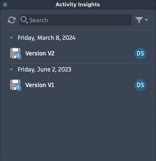

Use Activity Insights to see your teammates' contributions to shared drawing files, view version histories, and collaborate across AutoCAD products.
Activity Insights records each contributor's updates to a drawing file, streamlining collaboration and helping you pick up where you left off.
Note: Activities are logged even when the Activity Insights palette is closed. All activities are displayed the next time the palette opens.

All AutoCAD products record drawing activities. However, AutoCAD LT currently only displays Version activities on its palette, and AutoCAD for mobile does not have an Activity Insights palette. When working with collaborators across different AutoCAD products, make sure you are all saving to the same Activity Insights location.
AutoCAD, AutoCAD for Mac, and AutoCAD for web displays all activities for the open drawing even if a specific activity isn't supported within that AutoCAD product. For example, the STANDARDS command is only supported in AutoCAD on Windows. But if used, the Standards activity will show up in the Activity Insights palette for AutoCAD for Mac and AutoCAD for web.
