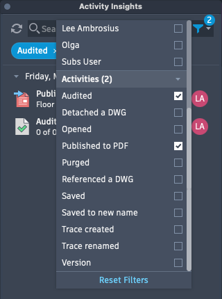

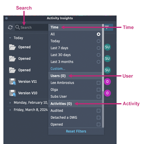

Filter Activity Insights
To filter the list of activities by:
    • Date: Select a date or range of dates from the calendar.
    • User: Select the user whose activities you'd like to see. Only users who have activities are included in the list.
      Note: AU stands for anonymous user for activities outside the product.
    • Activity: Select from the list of activity types for the current drawing.
    Note: You can select multiple options from the User and Activity filters.
  1. Enter text in the Search field to filter the list of activities based on path and file name.
    Path and file name can apply to any Xref events.
    Note: Search can be used on its own or with the Date, User, and Event filters.
  2. To clear any filter, select the All, All users, or All activities option from the filter drop-down menu.
