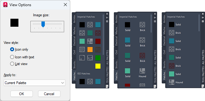

-  Views. Changes the display style and size of the icons on a tool palette.
