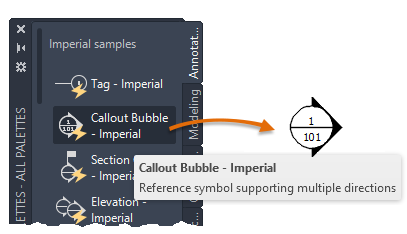

Here's an example of dragging or clicking and placing a callout bubble from the Annotation tab.

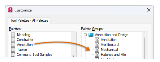

		To organize and reduce the number of tool palettes in the tool palettes window, you can define and display
		  tool palette groups. A tool palette group limits the number of palettes displayed in the Tool Palettes window. The Customize Palettes option provides options to create and organize tool palette groups.
		For example, you can drag a palette from the list in the left pane under a group in the right pane.
