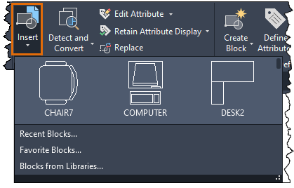

| Ribbon Gallery - On the Home tab, Blocks panel, you can click Insert to display a gallery of block definitions in the current drawing. Use the gallery when you have a small number of blocks to insert quickly by clicking and placing them in your drawing.
Note: Blocks associated with dimension and multileader styles are included automatically when you create dimensions and multileaders, so they're not displayed in the ribbon gallery or the Blocks palette.

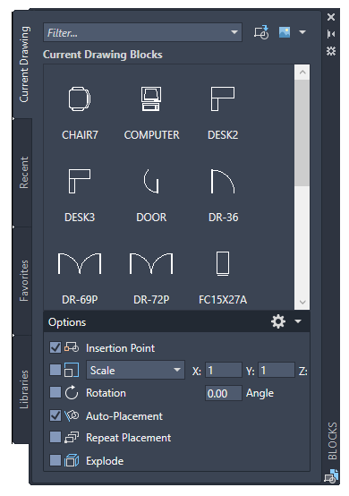

| Blocks Palette - The Blocks palette is designed for fast and anytime access when you use a moderate number of blocks in a drawing. In the Blocks palette, sign in to your Autodesk Account, and specify a cloud storage location to sync and access your blocks anytime, anywhere. This palette displays blocks organized into four tabs: Current Drawing, Recent, Favorites, and Libraries. You can access the Blocks palette with the BLOCKSPALETTE command. |
