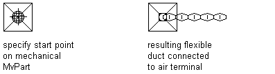

Connecting flexible duct to an air terminal

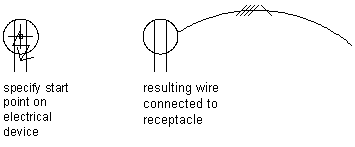

Connecting wiring to a receptacle

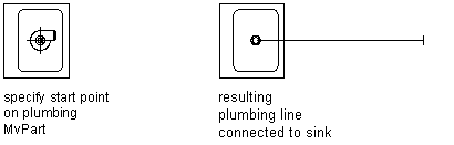

Connecting a plumbing line to a sink
