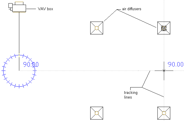

  5. Specify points to place the duct run.
    Drawing 1-line duct, top view
    Note: You can use AutoCAD MEP 2026 toolset snaps and tracking lines to align duct geometry with other objects and to maintain connectivity between objects in the system.

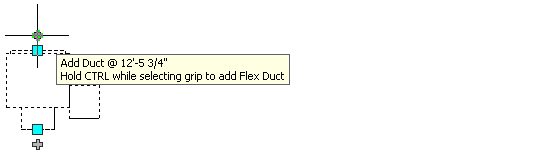

    When connecting to a part, especially at a different elevation than the duct run, more than one routing option may be offered. Use 2 viewports to get an accurate preview of each routing option. For example, the Aecb Model drawing template includes a Work layout tab where the workspace is configured for 2 viewports.
    Using 2 viewports to preview routing options

  7. To insert 1-line duct fittings, use the 1-Line tool on the Fitting tool palette, and complete the 1-line layout for the system.
    Top view of a simple 1-line system: A VAV box is connected to 4 air diffusers.
