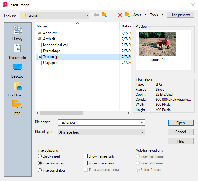

When you insert an image with the AutoCAD Raster Design toolset Insert command, you can preview the image and information such as file type, color depth, and density. The column of folders along the left side of the Insert Image dialog box is called the Places List. It contains shortcuts to local folders, such as your Desktop or Documents folder.

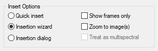

You can configure your inserted image in three different ways during the insertion process:
During insertion, you can change some attributes, such as the image scale, the color of the image frame, and the foreground color of bitonal images. For more information, see Inserting Images.
