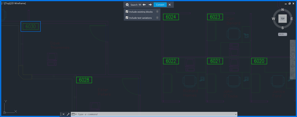

BSEARCH, formerly known as BCONVERT, finds all instances of the same geometry in a drawing for efficient block conversion.

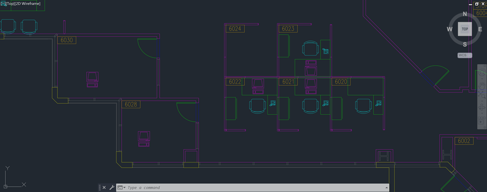

With this release, Search and Convert also finds text variations to convert into block attributes. This new capability is helpful for classifying repetitive but variable types of text, such as hotel room numbers or room names.
Once you decide to convert matching instances to a block, you'll see the preview thumbnail. Now, you can easily see the selected object and text variation.

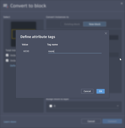

Along with converting matching instances to a block, you can then specify attribute tags for text variations by clicking Define attribute tags.

Once you run BSEARCH, the new Search review mode highlights all matching instances.
From the Search review toolbar, you can:
