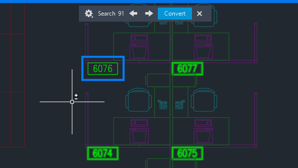

Smart Blocks: The detection capability and functionality are now fully implemented and no longer in Tech Preview.
2026.1 Highlights

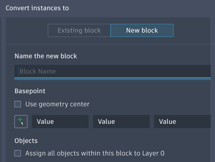

Smart Blocks: When converting instances to a new block, you can now assign objects within the block to Layer 0. This option is available in Search and Convert, as well as Detect and Convert. Additionally, you can now easily see where you are in the detection process.

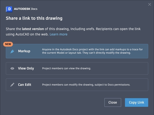

Multi-user Markup:
Autodesk Docs users can now share a URL of a layout or Model tab with collaborators, who can add markups to a trace in AutoCAD on the web using Autodesk Docs markup tools. This enhancement allows multiple collaborators to easily share drawings and add markups and revisions.
