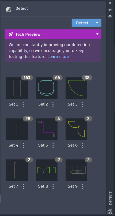

Once you run BDETECT, the Detect palette will show all detected sets in a new thumbnail view.

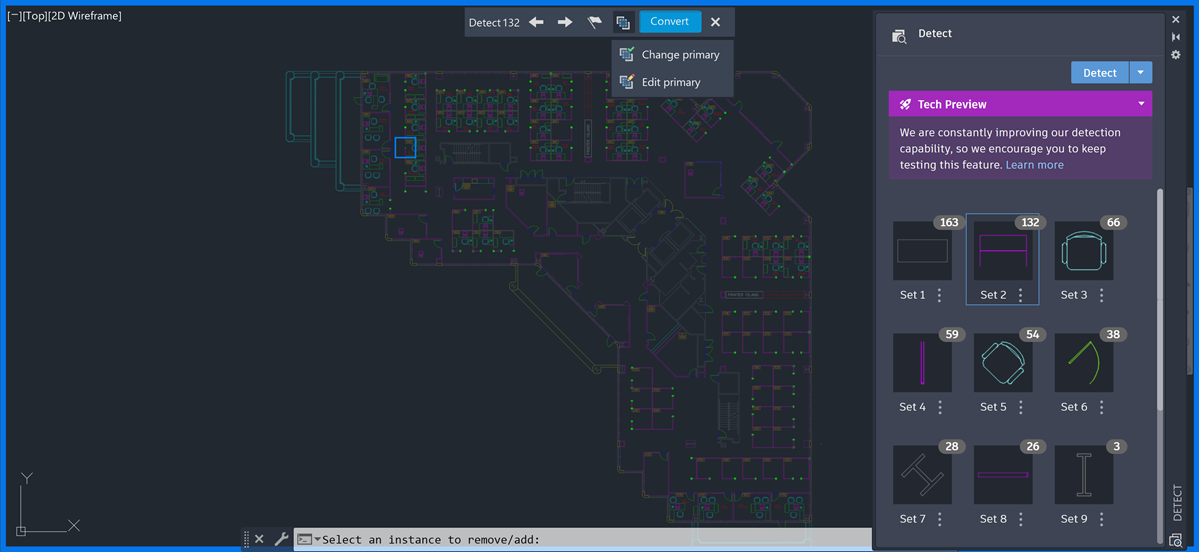

Once you click on a set, the new Detect review mode highlights all found instances.
From the review toolbar, you can:
- See the total number of found instances
- Navigate to the previous or next instance in the drawing
- Change or edit the primary instance
- Convert to block
Option to edit or change primary instance

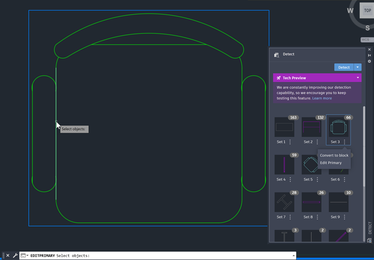

With this release, Detect and Convert now allows you to edit or change the primary instance. Now, you can choose a different primary instance by selecting Change primary from the review toolbar.
Or, you can add or remove objects from the selected primary instance to edit it and refine your search. The Edit primary functionality is available from both the review toolbar and the palette.
