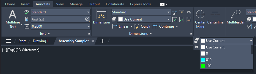

Added Layer Option to CENTERLINE and CENTERMARK
In this release, we integrated the CENTERLAYER system variable into the workflows of creating new centerlines and center marks.
The value of the CENTERLAYER system variable can be changed:
  • At the Command prompt, using the new Layer option of the CENTERLINE and CENTERMARK commands.
  • On the ribbon, Annotate tab > Centerlines panel, using the Layer control.
