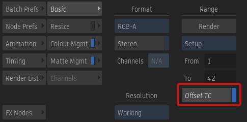

Offset TC in Exported Clips
The Range Offset button in the Render Node changes.
Note: Write File nodes present in setups from previous versions have this option enabled.

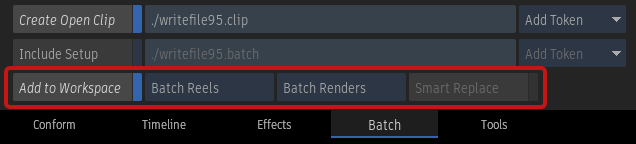

Add Exported Clips Back to the Workspace
A clip exported using a Write File node can now be automatically added to the current workspace by selecting the Add to Workspace button.
Just like with a Render node, you select where the clip is added.
This option is not available when you export a clip using Burn or Background Reactor.

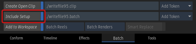

Bundling Render and Write File
If you select the Include Setup in the Write File node, the created Batch Setup now includes every Render and Write File nodes from the Schematic.

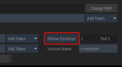

Open Clip Padding Follows Iteration padding
In the Write File node, if you enable Follow Iteration, the Open Clip version now uses the same padding value as the Iteration of the Batch Setup.

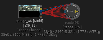

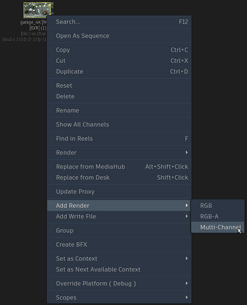

You can now add the Render and Write File nodes from a node's context menu.
This option automatically sets the proper number of channels required and connects all the node's outputs to an input socket on the output node.
The names of the output sockets are also used to name the channels in the Render or Write File nodes. For more information, see Channels in Render and Write File Nodes.
Smart Replace relocation
The Smart Replace button is now available in the Add to Workspace settings of the Write File node.

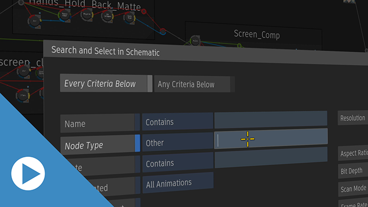

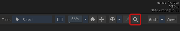

Search Nodes in the Schematic
Flame Learning Channel: Searching through Batch
You can now search for nodes in the schematic for Batch and the Modular Keyer.
In addition to being able to search by Node name and resolution, you can locate node in the Schematic based on:
You can also create Search presets for those often-used searches. These presets are accessible from the Search drop-down menu.

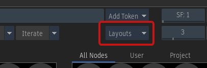

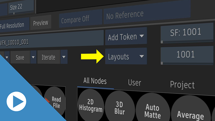

Layouts in Batch/BFX
Flame Learning Channel: Customising your UI with Batch Layouts
Layouts are now available in Batch and Batch FX.
The following elements of the Batch tab can be managed with a Layout:
The Batch user interface changes somewhat to make room for the Layouts button:
Before 2023.22023.2
