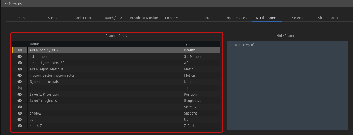

Changing the Assignment of Multi-Channel Types

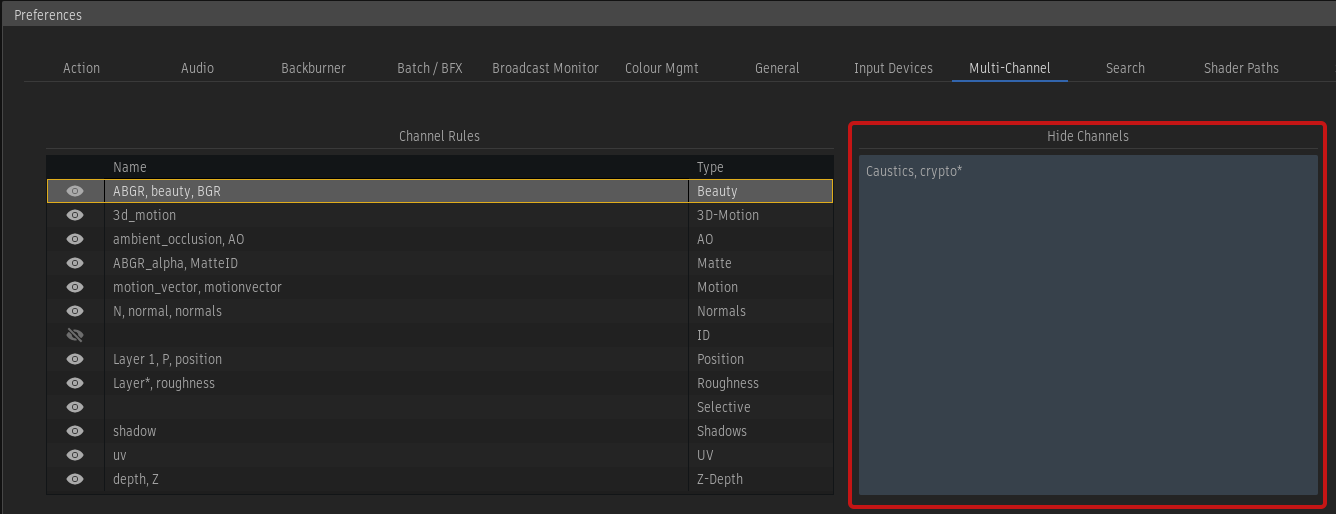

How channel names are mapped to channel types is described in Preferences Multi-Channel Channel Rules.
Important: The mapping in Multi-Channel Channel Rules applies to all Flame Family products and versions installed, as well as to all projects and users on the workstation.
Use the Multi-Channel Channel Rules to map a channel type to a channel name. A channel name comes from the clips that you import. This name is given to the channel when that channel is created in another application such as Autodesk Maya. The default preferences contain standard channel names, but you can add or remove channel names from the list.
A channel type describes the purpose of the channel. It corresponds to Action outputs, like Beauty or Motion. This list is finite: you cannot add channel types.
To change the mapping of multi-channel type to channel names:
  1. Open Flame menu Preferences Multi-Channel.
  2. In the Channel Rules table, locate line with the type you need to reassign.
  3. In the Name column, double-click the field.
  4. Add or remove a channel name from the list.
    Use wildcards * (any number of characters) and ? (any one character) to complete a name or replace a specific character. For example: lay* for layer, layers, and layout, layer? for layers and layer1 but not layers1.
  5. Close the Preferences panel.
Changes to the types in Channel Rules are applied immediately to all imported clips. This only changes the type of the channel, and channel types are only informative, so it will not break links in Batch.

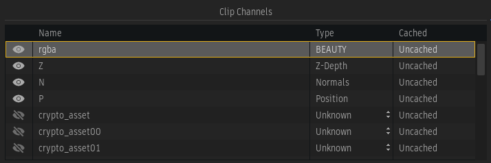

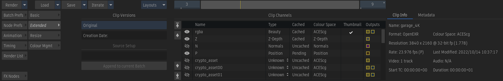

Unknown Channel Type
When you import a multi-channel, its channels are assigned a type. What type is assigned to what channel is defined in Preferences Multi-Channel Channel Rules.
Channels that are not listed in Channel Rules are assigned the Unknown type.

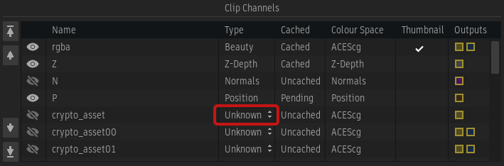

While you cannot change an assigned channel type in a segment or clip node, you can assign a type to a channel flagged Unknown.
To change a channel type from Unknown:
  1. Go to the proper location:
    • In Timeline: Open Timeline FX ribbon Format Options Extended.
    • In Batch, Batch FX, and Modular Keyer:Select the clip and open the Extended menu.
  2. Find the channel in the list.
  3. In the Type column, click Unknown and select channel type from the list.
  4. In the Add Channel Rule dialog box, confirm the channel type to be assigned.
    This dialog box actually adds the rule to the table in Preferences Multi-Channel. And because edits to Channel Rules are immediately applied to all imported clips, every channel with this name is assigned this channel type when you click Add.

Hiding Channels On Import
You can set the preferences so that specific channels are hidden in clips when you import them.
You can hide channels in a multi-channel clip based on the type of channel. Or you can hide channels based on the name of the channel.
To hide channels on import based on the channel type:
  2. In Channel Rules, click .
  3. Close the Preferences panel.
To hide channels on import based on the channel name:
  2. In Hide Channels, enter the channel name.

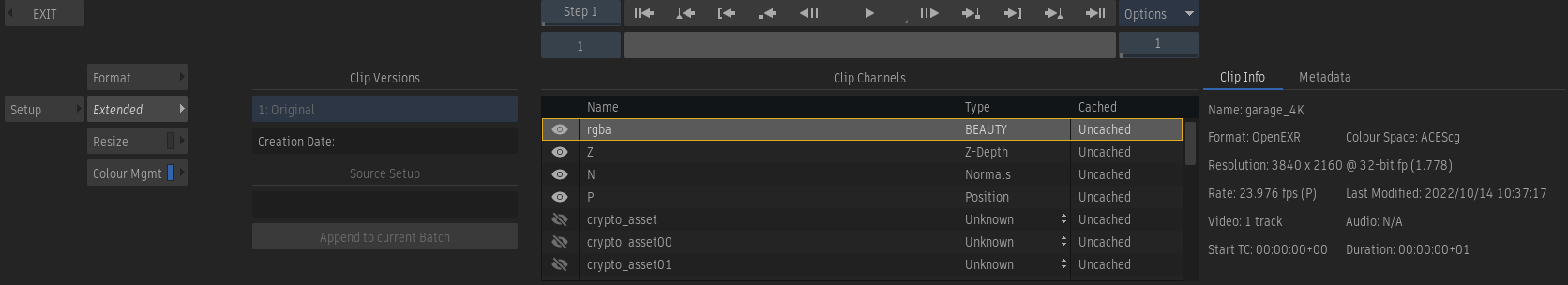

In the Timeline environment:
  1. Open Timeline FX ribbon Format Options Extended.
  2. Click to hide the channel.
  1. Select the Clip node and open the Extended menu.

About Hidden Channels and Media Cache
Hidden channels are not cached. The media for a clip's hidden channels is not cached.
Use context menu Media Flush Cache Media (Hidden Channel) to flush the media of channels hidden. Use this option if you hide channels after importing the clip.
Use context menu Media Cache Source Media (any variant) to cache the media of channels you change from hidden to visible.
You can always check if a channel is cached or not.
To view the cache status of a channel:
  2. Find the channel and look at the Cached column.

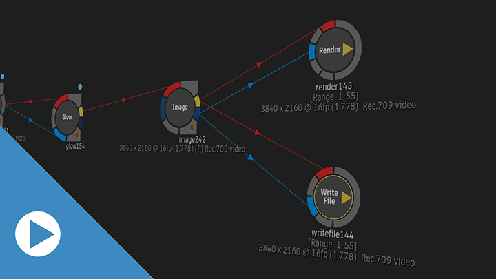

Channels in Render and Write File Nodes
Flame Learning Channel: Render & Write File Updates
You can now use the context menu to quickly add a Render node or a Write File node to the Schematic with their inputs connected to a Clip or node.
This option is great to connect multi-channel Clip or an Action node to an output node without having to manually connect each output socket to its matching input socket.
To add an output node with inputs already connected:
When you use the context menu, the names of the output sockets are used to name the channels in the Render or Write File nodes.

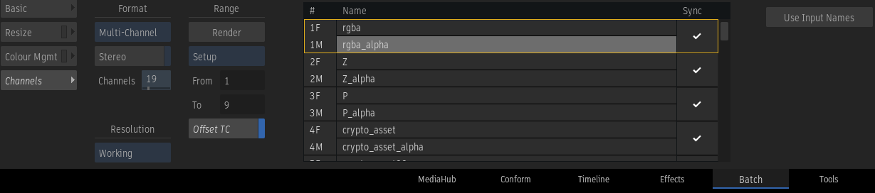

Rename Channels in Render and Write File
In the Render and Write File nodes, you can now have access to the channels of a multi-channel output.
The channels that make up a multi-channel output are displayed in the new Channels menu.
In the Channels list, every channel appears with its Front and its Matte.
When you add a Render or Write File node using the Multi-Channel option in the context menu, the channels are created using the names of the Outputs from the original node. But you can edit these names.
Tip: Use the mouse wheel or the trackpad to scroll the Channels list.
To edit the channel names, you can:
The Sync option keeps the name of the channels connected to the Front input and its corresponding Matte input the same. In this scenario, "_alpha" is append to the name of the matte channel.

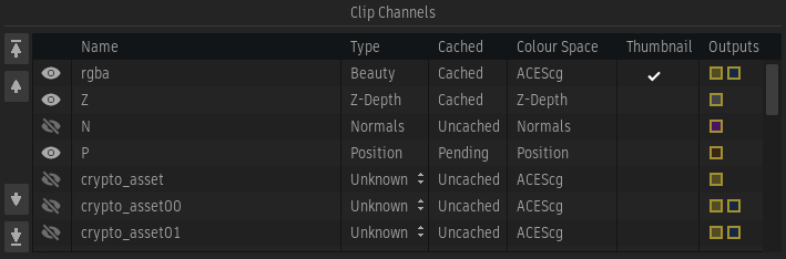

Reorder Channels in Clips.You can now reordered channels of a Batch Schematic Clip. By using the arrows next to the Channels list in the Clip's Extended menu, you can move channels up or down the list.
Updated Channels table. In addition to the new Type and Cached columns, the Channels table in the Extended menu of a Clip node contains the following improvements.

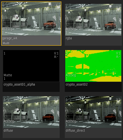

MediaHub
The tiles for channels that are set as hidden in Flame menu Preferences Multi-Channel are now displayed in a darker colour when you double-click the clip Multi icon to display its channels.
In Flame menu Preferences Multi-Channel, crypto* has been added to the Hide Channels table. In MediaHub, the channels crypto_asset01_alpha and crypto_asset02 have a darker border to indicate that they are hidden.
