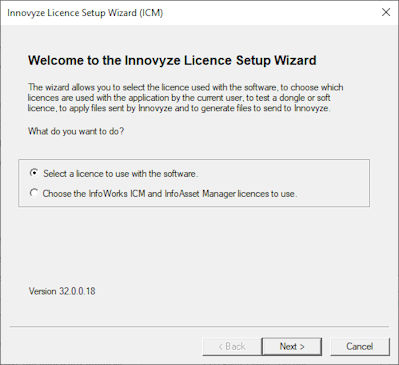

A subscription based Thales licence is required to access Innovyze products. In order to use a Thales licence, it is necessary to perform a simple configuration step on each client PC.
The Licence Key Setup program can be run from the Windows Start menu by typing 'InfoWorks ICM Licence Key Setup' in the Search box and choosing the application with the relevant version number from the list of suggestions.
When the program is launched, the Welcome page is displayed:
The setup wizard options are:
Click Next to display the next page of the wizard for the selected option.
