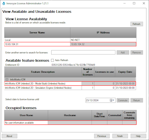

These licences are simple to install, and additional users, software or features can be added to the licence remotely with little user interaction. You can also see who is running what using the Innovyze License Administrator (ILA), an example of which is shown below:
This type of licence allows the applicable software to run on your PC or network or remotely. An entitlement ID (EID) is provided by us, which your system administrator, or a user with similar privileges, uses to set up the license on a PC or network server using the ILA.
The ILA is automatically installed when the Innovyze version of ICMLive Operator Client is installed.
Note: If you are using Autodesk ICMLive Operator Client, your administrator will need to install Autodesk ICMLive (the Autodesk version of InfoWorks Server Configuration Manager) so that they can use the ILA, which is installed with Autodesk ICMLive, to setup the licence for Autodesk ICMLive Operator Client.
